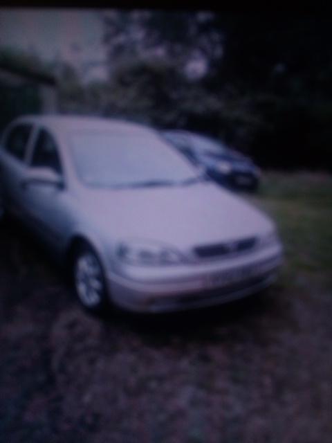

  24. Hi Ray, welcome aboard the forum. Would be great to see some pictures of your S reg Astra. I am in a mk4 "G" Astra. Regards AndyR
