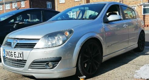

  21. Heres mine. Excuse the battle scare thats from the previous owner
