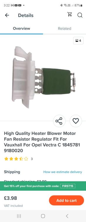

Hi Keith,  have you tried the resistor ? Has failed on mine twice over its 20 years.  Also had sa.e symptoms

Had the same problem with my Astra when I first got it. It too was the resistor on the heater motor . Replaced and all working ok.
