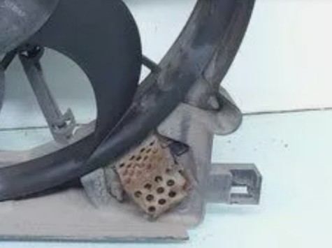

I have no Thermo switches on the radiator itself, but there is what looks similar to the heater blower resistor on the fan . Could it be this at fault?. Also checking the fuse box, and found that the fuse which I think relates to electric fan is missing. So brother in law is going to do a circuit test tomorrow to see if there is any power to the fan.  Will then replace fuse and see what happens.

I have found out that the Astra G mk4/5, doesn't actually have a separate switch/sender for the electric cooling fan in the radiator.
It is however integrated in with the sensor for the temperature gauge, and apparently the ECU senses the spike in temperature and tells the fan to kick in. But as mine isn't doing this because my gauge is not reading correctly,  the ECU isn't sensing the engine temperature properly,  hence why I've had some over heating issues.
So this morning I have ordered a new temp sensor, and will be replacing the old one.
