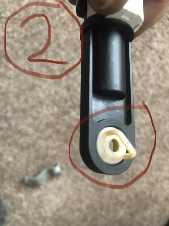

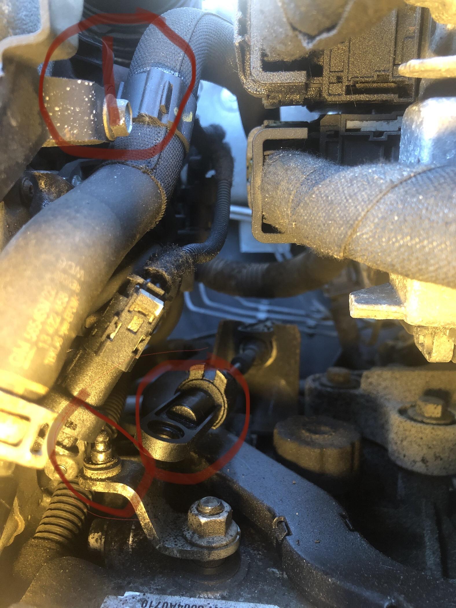

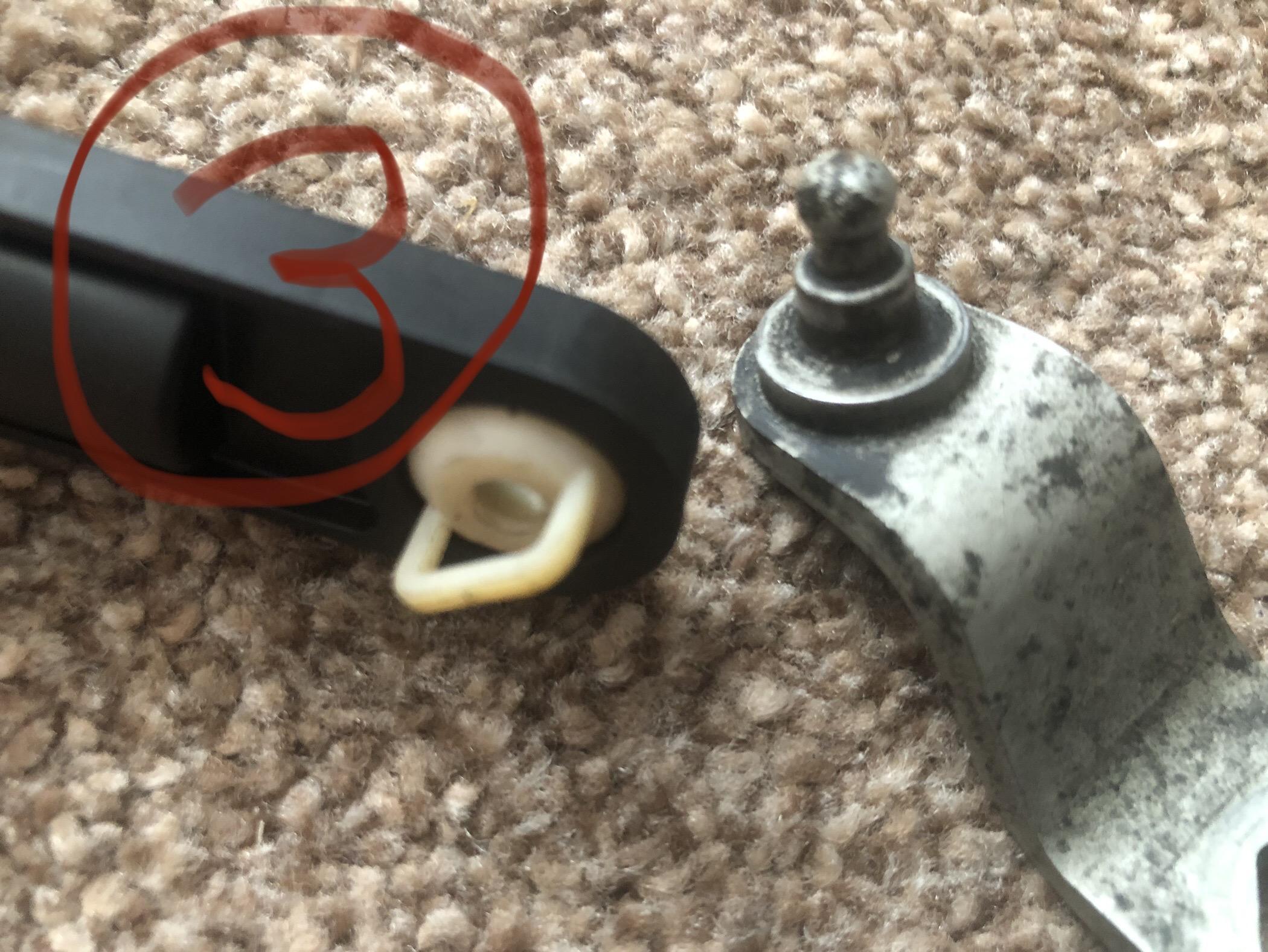

Last week on a long drive home my car suddenly lost all drive. ( imagine that on a smart motorway ). I then realised car had  slipped into neutral on its own. Managed to get home by tightly holding gear lever into Drive position but car trying to get in neutral all the time. When home looked under bonnet and could just see where gear change cable connects to gearbox. It was disconnected due to a plastic BALL JOINT that was broken and completely missing. The cable end with the missing ball joint had just a 10mm hole left. ( photo 1 )

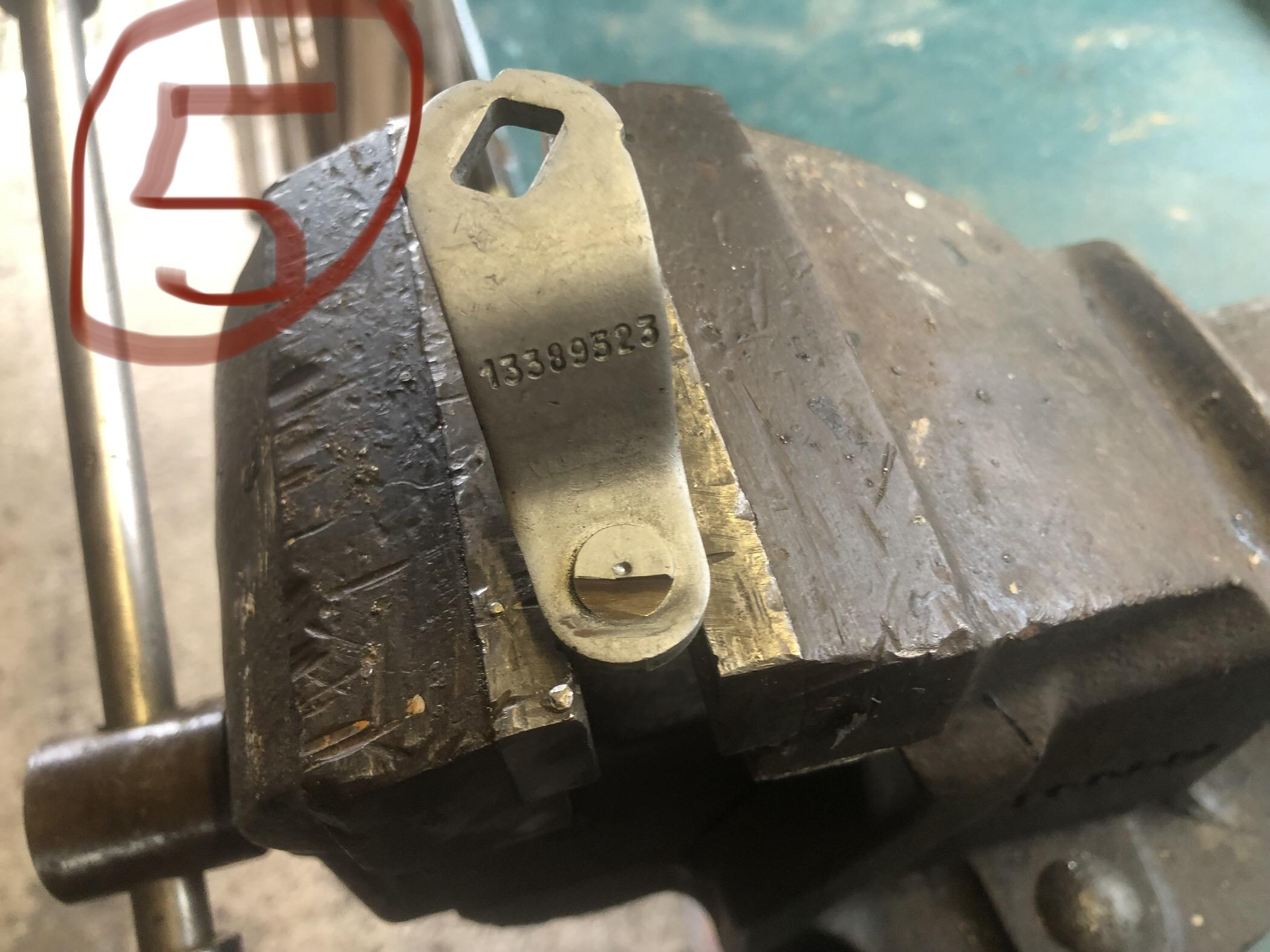

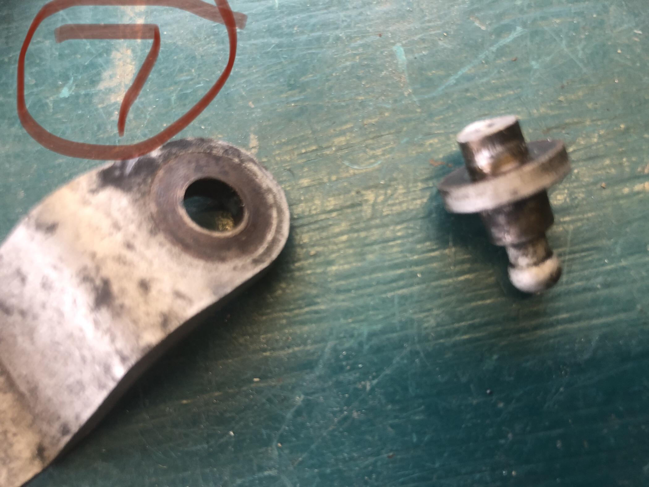

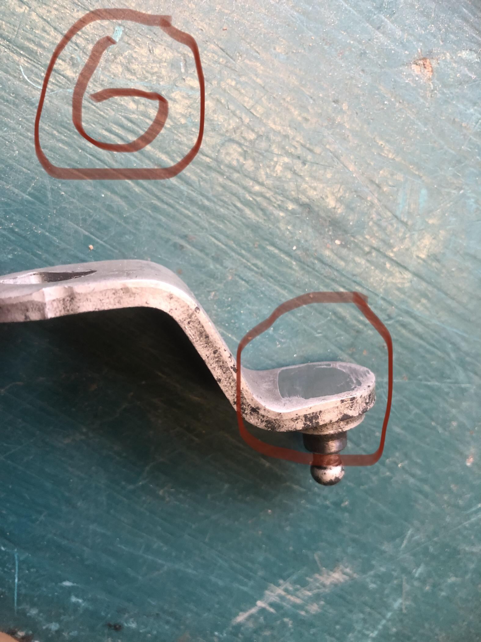

Purchased new cable and found the missing ball connecter was just a small piece of plastic  ( photo 2 and 3 ). This part could easily be removed and fitted in original cable.

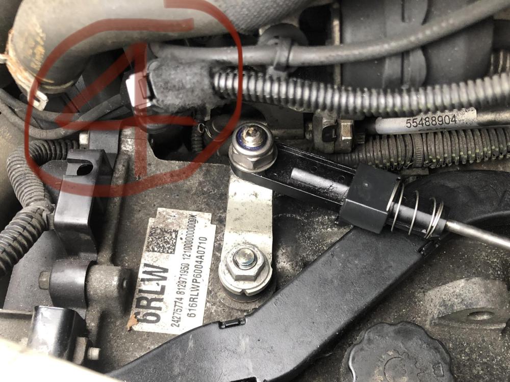

This so called ball joint is a very weak Micky Mouse connection so decided to make a simple stronger modification ( photo 4 ).
Note :  The nut on photo 4 must be NYLOC type and adjusted so joint can move, use a bit of grease.

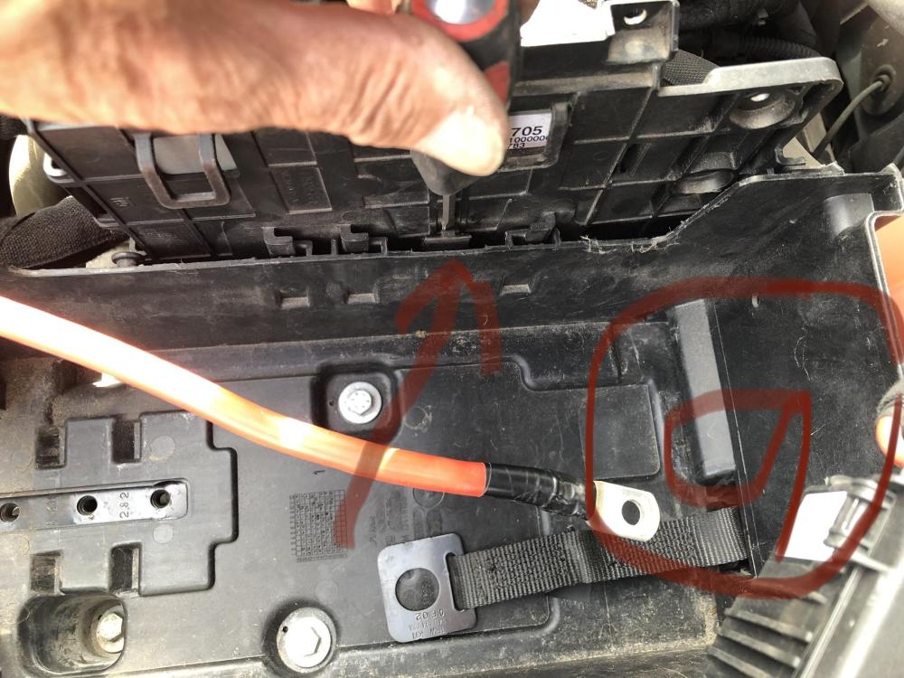

To do this modification APPLY ELECTRONIC BRAKE, DO NOT FORGET TO DO THIS. Then remove battery and battery box. The cars engine management computer can be lifted up by releasing ONE clip ( photo 9 ) with a screwdriver. No need to pull hard on this it’s very easy after you have found the clip see photos. Also note 4 sliders to hold computer when refitting. DO NOT unplug any computer plugs.

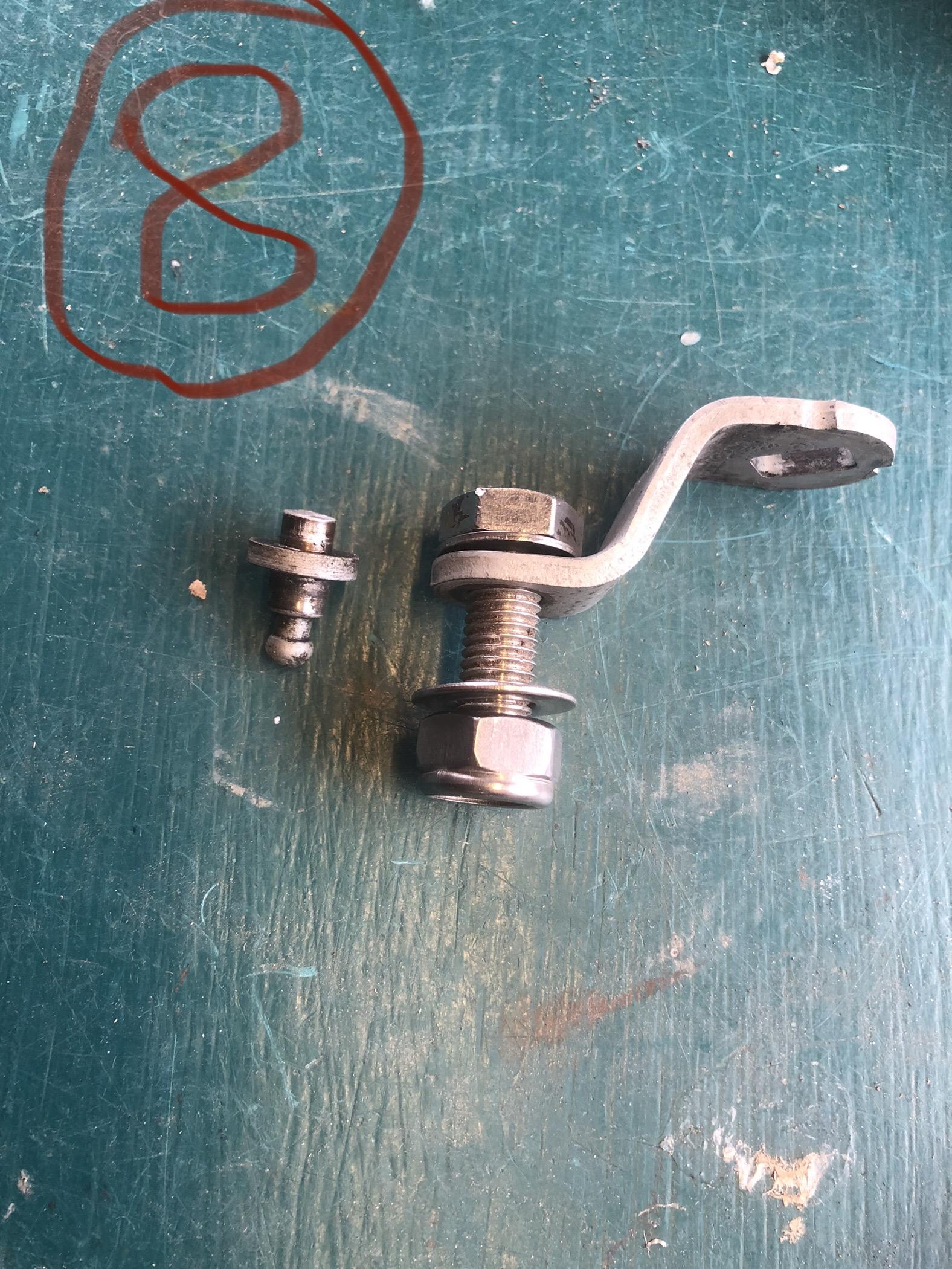

Follow photos  ( 5 to 8 ). Unbolt bracket and cut off metal ball using angle grinder ( this ball is very hard so CANNOT USE DRILL ). Once back of ball has been ground off just hammer out with punch.
The bracket can then be drilled out 10mm dia.

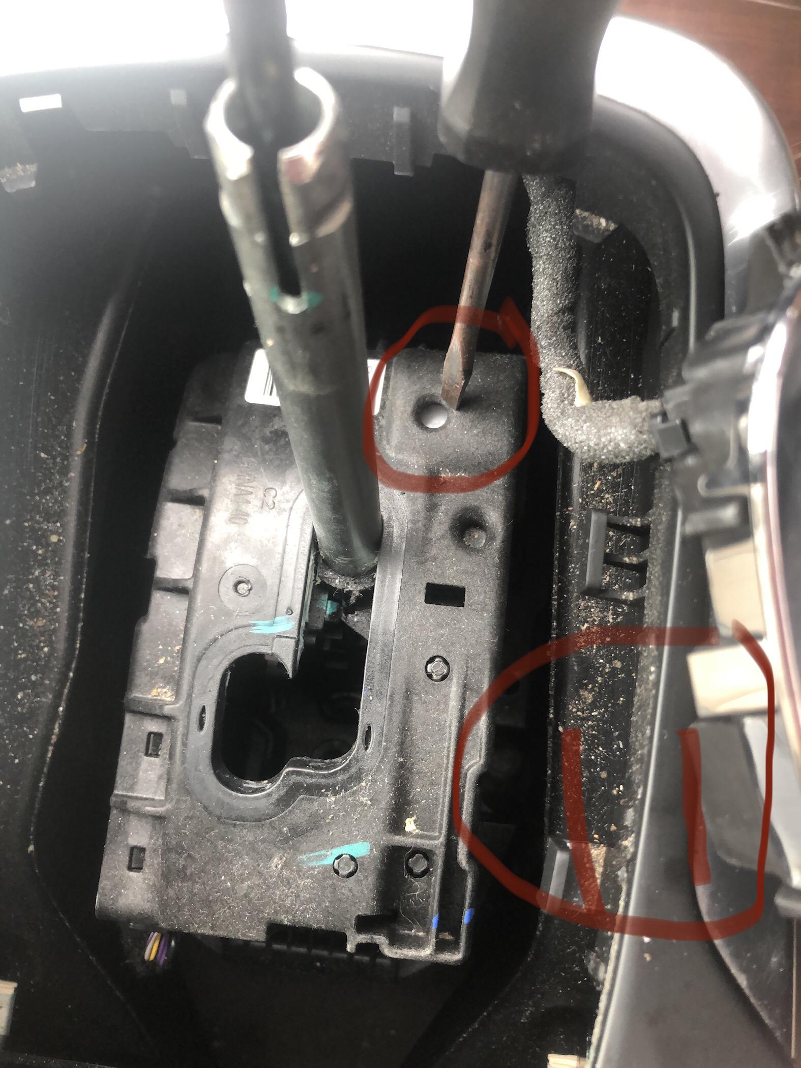

Photo 11- To unlock parking lock ( P ) with dead battery press down with nail or screwdriver then move gear lever.

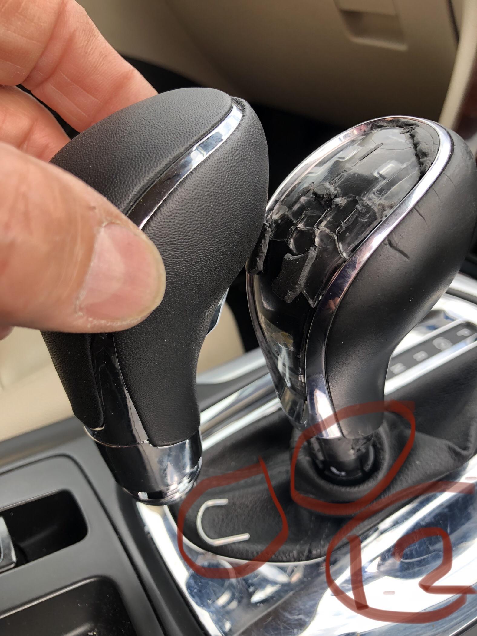

Photo 12- Gear lever knob has to be broken to remove holding pin clip. Just break silver plastic at bottom of knob and pull out clip. New lever just pushes on.

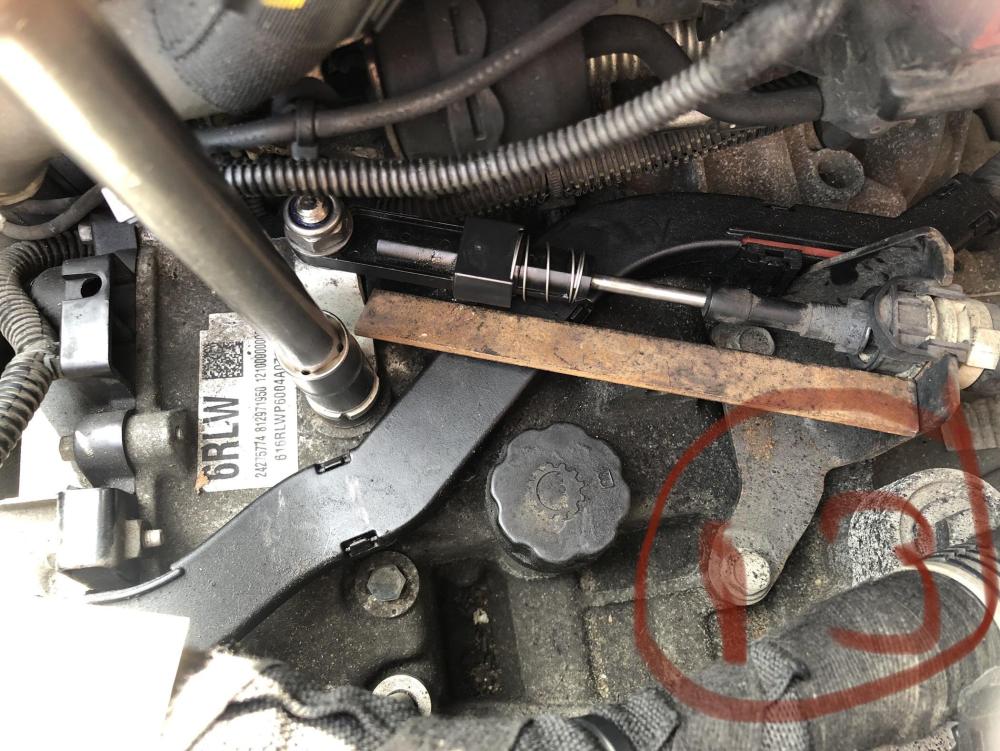

Photo 13- Put gear lever in P park position and use 6.5 inch long metal rod or wood to avoid damage to gearbox selector switch when tightening bracket nut. Maybe not necessary but don’t know how switch end stop works inside gearbox.

I had a few days with problems getting into drive and eventually had to hold gear lever tight in D position as it would jump to N. I could see the broken plastic joint by looking under the battery box with a good torch. Have you looked to see if this plastic ball joint is missing like I had.
