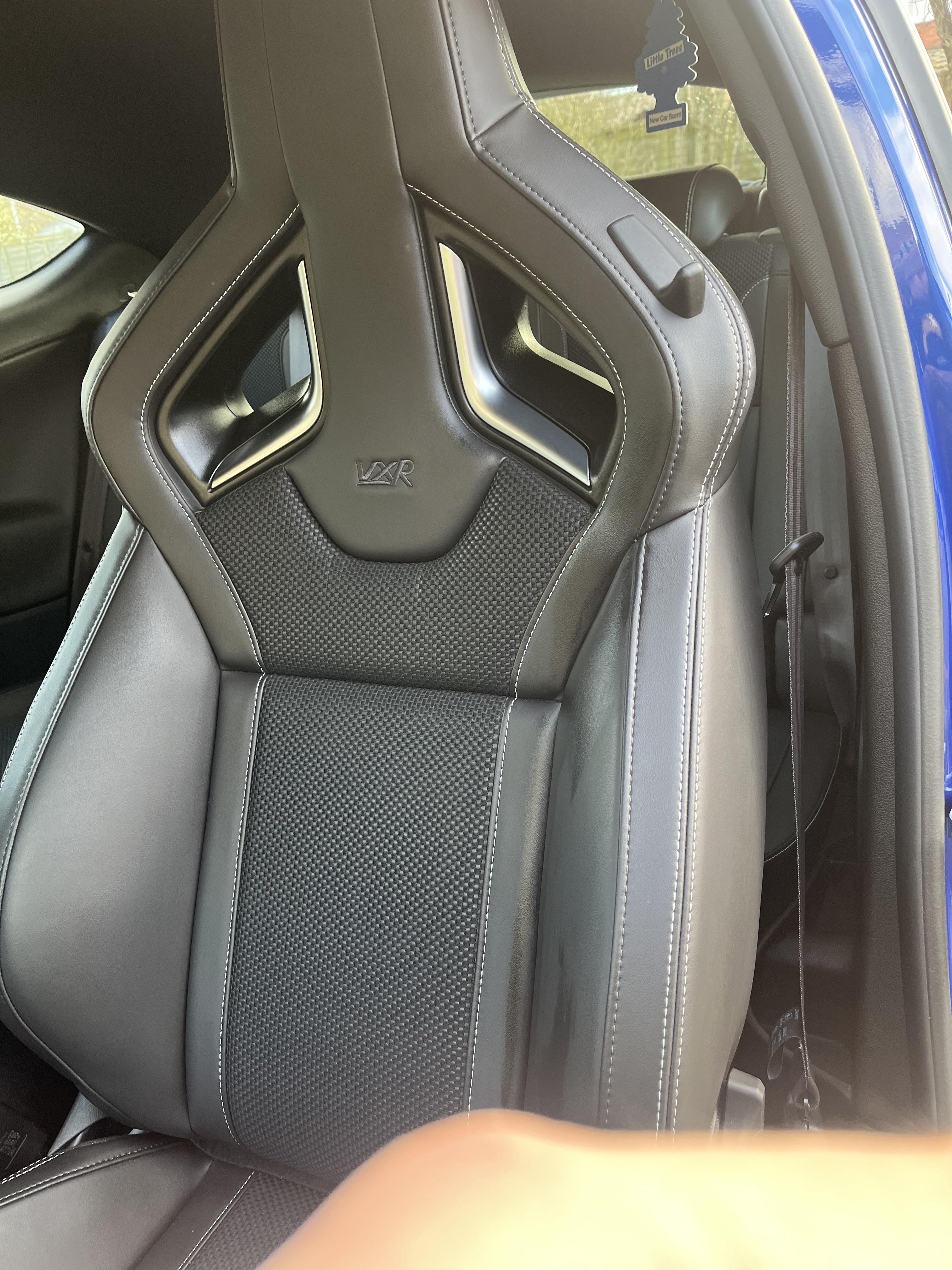

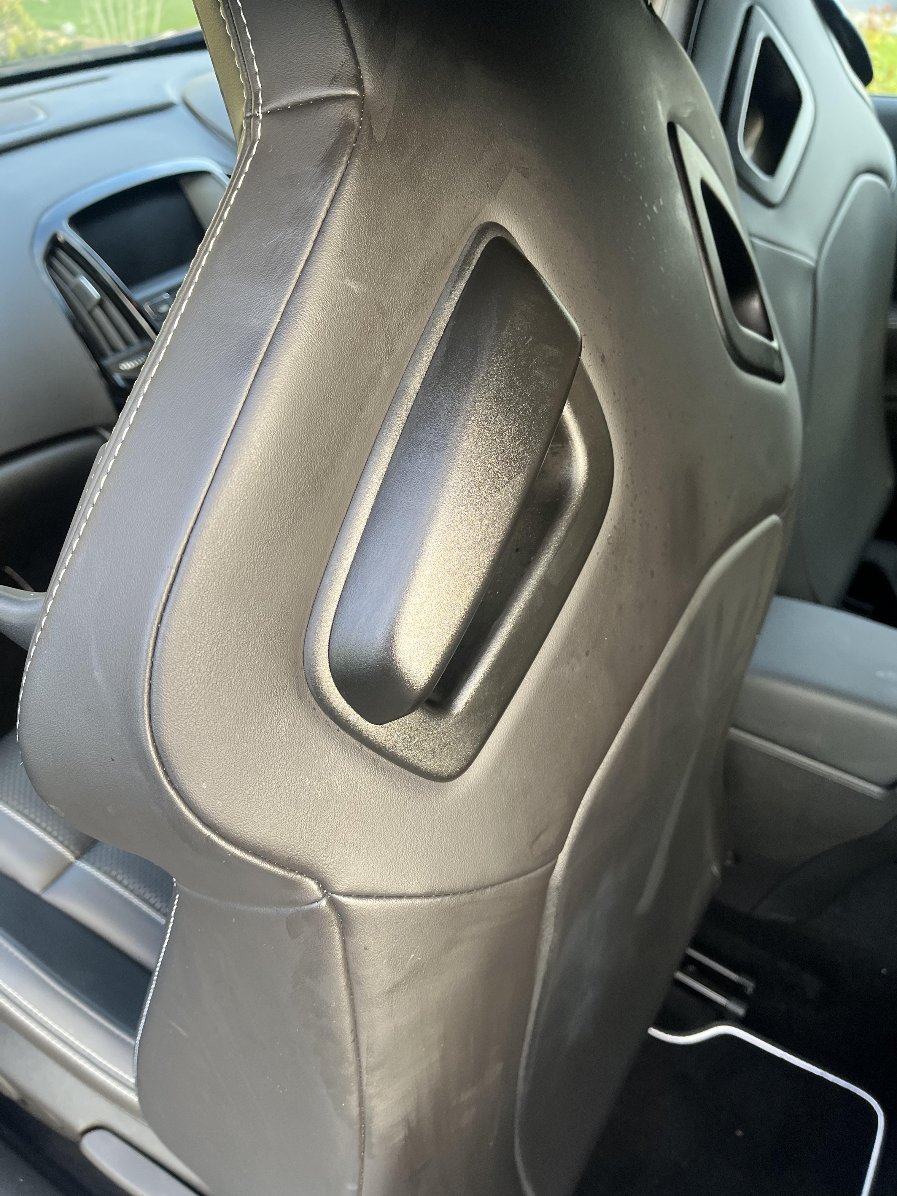

I’m after some assistance please. I’ve recently purchase a 2018 Astra VXR, and I’m having issues with the passenger side seat release handle, feels really stiff and like I’m about to break it. Getting embarrassing when I have more than one passenger
Is there anything I can do to enable the mechanism to function better? Was thinking some WD40 but can’t see any mechanism showing as they covered in plastic
Images attached below
It helps to assist the seat back retraction by applying some backward pressure against it before pulling the release lever.
Its the same on my Alfa Romeo Mito (in fact the drivers cable has now snapped) but by pressing against the seat back to alleviate the sprung pressure that is on the mechanism it makes it much easier to release and less chance of breaking anything
