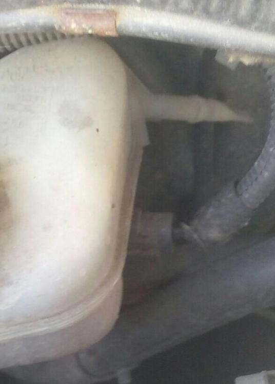

  14. Hi Trevor, got delayed in the servicing, but have done all today. Oil definitely needed doing, as very black. Air filter box removed and all dirt and leaves removed. And how deep are those spark plugs, !!! Did check them , and number 3 was a little oily around the thread, but all were a nice biscuit colour. I then moved on to the coolant flush. Wasn't as bad as the header tank looked. Am wondering if the previous owner put some sort of additive in with the very weak antifreeze solution. Have now put fresh antifreeze in and all seems well. Might give it a month and flush through again just to make sure. The car certainly seems more responsive now. 😉😉 Hope you are well, and thanks again for your help. Regards Andy
