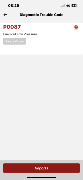

IMG_4790.thumb.png.ee8f5d937b251f3c06e03e0bee92a491.pngMine seems to fault more when it’s cold. Only one fault showing in DTC. This turns on the Christmas lights.

Hi to all, after long and thorough investigation. I think i made progress.
The issue i think its related with adblue injector. When it's faulting it triggers the low pressure common rail fault and then all the others.
I cleaned mine the last month and everything is good for about 5000 kilometres.
Hi, was it the P0087 fault coded triggering?
What is the process to clean the add blue injector, guess it’s on exhaust near DPF? Thanks Mark
