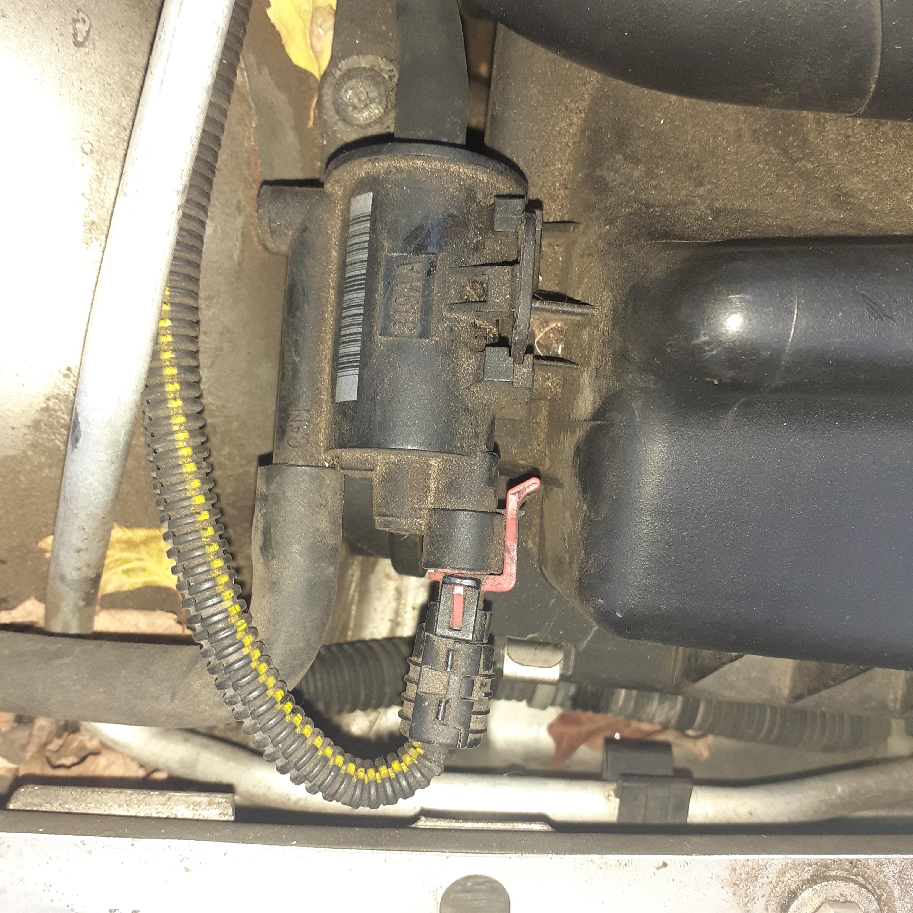

  23. Hi everyone, I'm in the process of doing maintenance on the astra. I am going to do a coolant flush and refresh, and also sort out the egr system. Does the coolant work with the egr, as I've noticed that the heater pipes are connected to the pipework from egr. And would having a clogged coolant system cause the egr to misbehave? Thanks in advance Andy

  25. Hi there, have you had any diagnostics on your Agila. I wonder if maybe you need to get the EGR valve checked. My Astra throws up the EML when EGR is playing up.
