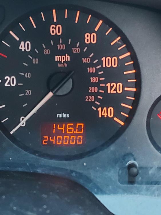

  18. Is that the one that also gives the outside temperature reading? It is in middle of front bumper behind the bottom grille.

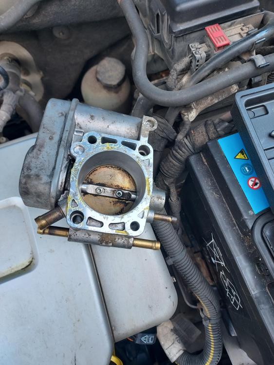

  24. Here's the update on the astras running issues. Changed out the fuel filter this evening, and after a rough start and idle, she seemed to pick up. Took her out for a test run, and first junction after a mile, she cut out. Restarted straight away. Went on a run for about ten miles, and withhaving to stop every so often as it's narrow country lanes around here. She had no issues of stalling. Gave her a good hard run on the clear straights, and yes she's back toher good old self. Pulling like a trojan, and stopping without cutting out. So if anyone has these issues. Then I suggest replacing fuel filter. Tomorrow we're off to the coast. So some fresh fuel and a good run should sort her out.

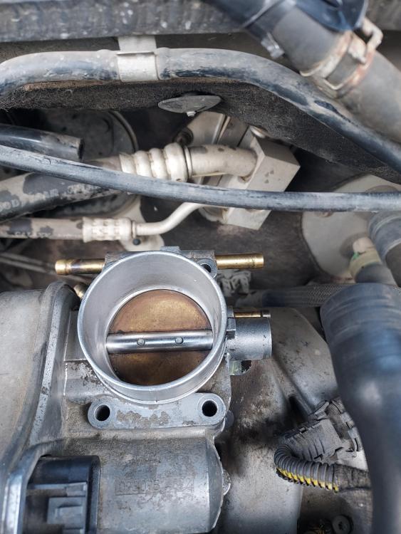

  25. Well the clean up of throttle body improved the performance and the idling is a bit better. I have invested in a new fuel filter as apparently it can give the same symptoms that i am suffering with at the moment. So at some point tomorrow afternoon, i will swap them over and see how it goes. WATCH THIS SPACE FOR NEWS ON THE OUTCOME.🤞
