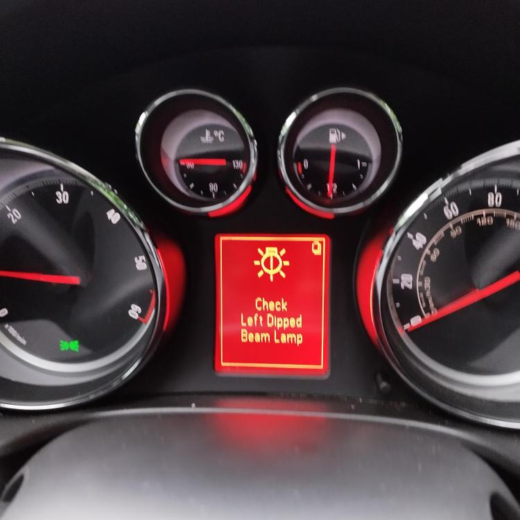

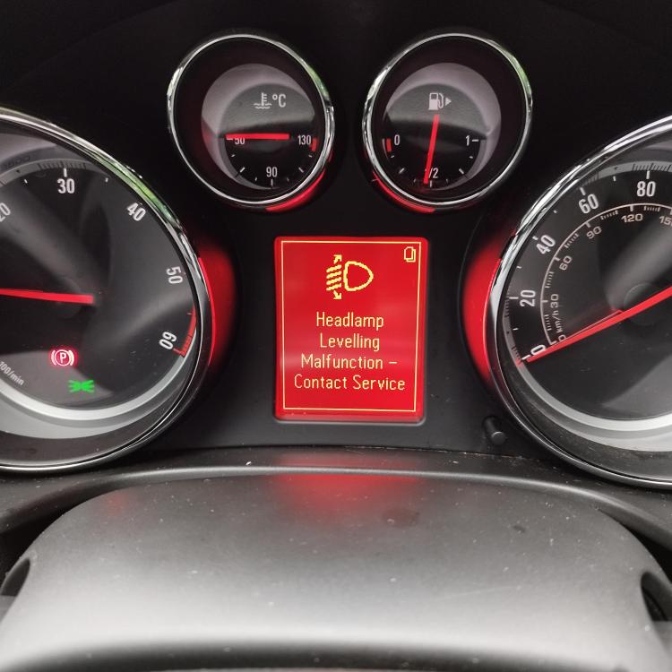

Either a plug to the lamp has become detached or even a rear suspension suspension level sensor rod has become detached

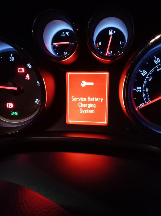

Two things I can think of - 1. if the belt has previously come off then was the tensioner okay or is it worn and therefore throwing the belt off? 2. a split turbo pressure hose to intercooler can produce this sound

Up date on issue took a look at it and belt was off, puzzled really if belt was off how is I could drive car with message on dash, so refitted belt and the message as gone so I tested the battery (engine off) was reading 11.35 (engine on) reading 14.56 so took it for drive tonight no message back and belt still on strange, but still have a loss of power in car but this just may be down to the intercooler pipe as I may have a split in it some where as engine makes a whistling sound when accelerating would I be right there

My Vauxhall Insignia diesel 2011 is displaying the following: Headlamp Levelling Malfunction -contact service, and Check left Dipped Beam Lamp. How can it be erased and or fixed. Thank you
OK out in car today and it started playing up as I was driving up hill seems to be like power loss it was like it was going up and down soon as I put my foot down to get up to speed and later on I had message on dash, car as had new turbo solenoid fitted and as had the coolant leak sorted out but now this and battery ight on with message
