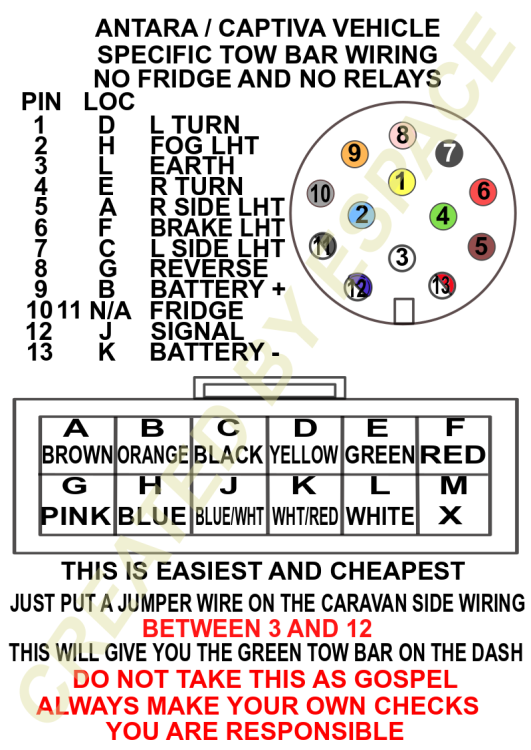

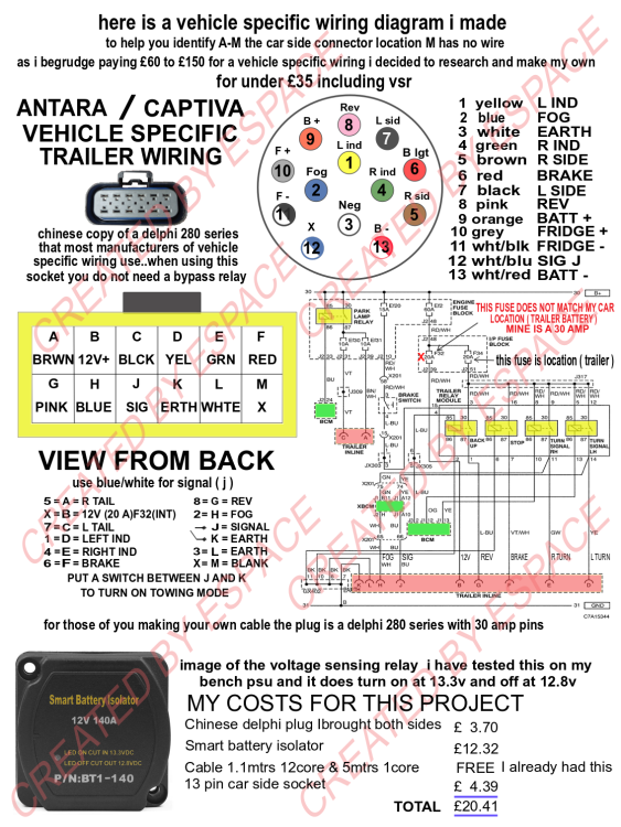

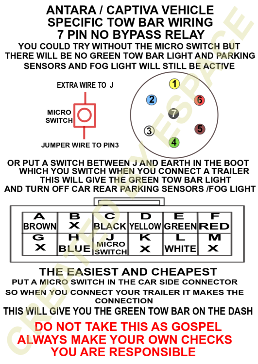

  1. here is a pic of tow bar wiring to use the way your car was intended and one for 7 pin no bypass relay required
  2. if you have a different model want to make one here is a list of what i did 1. get a wiring diagram for the trailer connector 2. take a picture of your connector ( there usually delphi type 280) 3 .workout the wiring from the wiring diagram if you are buying new wire for this then consider updating your caravan/trailer wire at the same time i had updated my caravan before up grading to my antara so i used the old cable if you need help then post here
  3. don`t buy opcom v1.99 it is guaranteed fake if you update it you will brick it look for one that has no d5 diode and c22 capacitor i have heard the v1.95 is the least likely to have fake chips
  4. i added an extra earth to position M for battery earth pin 13 ( there is a bung in M that needs to be removed ) i used position K as fridge earth pin 11 i put a jumper wire between pin 3 and pin 12 on the caravan side to send connection signal to position J i used position B as fridge +( only problem is this is live all the time )
  5. here is a vehicle specific antara wiring diagram
