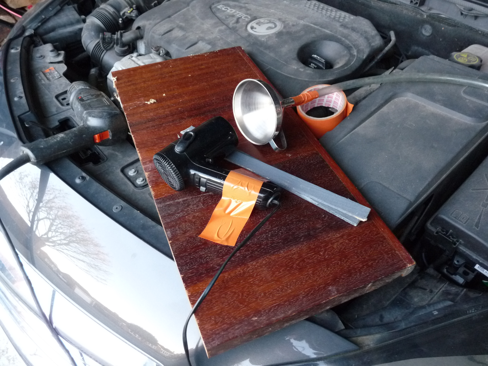

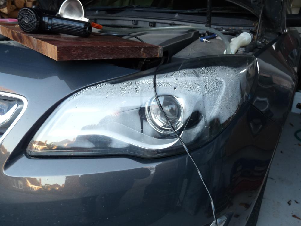

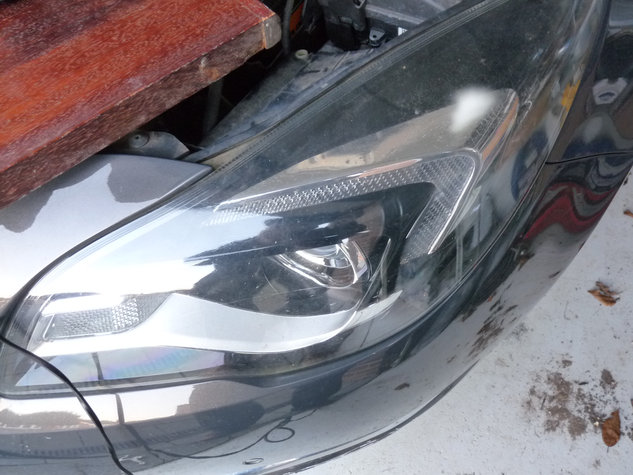

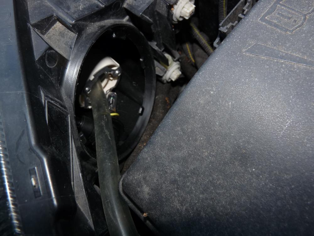

  2. I have a lot of condensation in the near-side headlamp in a 2014 Insignia Ecoflex. I Removed headlamp bulb and fed a plastic tube through the hole. I set up a hairdryer facing a metal funnel taped on to the tube. I played a B&D heat gun across the headlamp face and, with impatience, damaged the top corner of the headlamp. (see 04 picture, white spot at top-right of the headlamp) Eventually the condensation evaporated, but I am not convinced that the tube was blowing hot air into the front space of the headlamp because there appears to be a lens in front of the bulb position. I guess It might have taken 30 minutes. The near-side headlamp is cluttered with the battery box and earth cables. I should have tried to remove the other bulb - maybe that might have given, either better access for the hot air, or better escape for it. I left the hairdryer running for another 15 minutes before closing up. I see that a small amount of condensation has reformed at the edge already. Has anyone info on the internal construction of the headlamp? Is there access for air to the front space from the bulb position? Does the other bulb give better access?

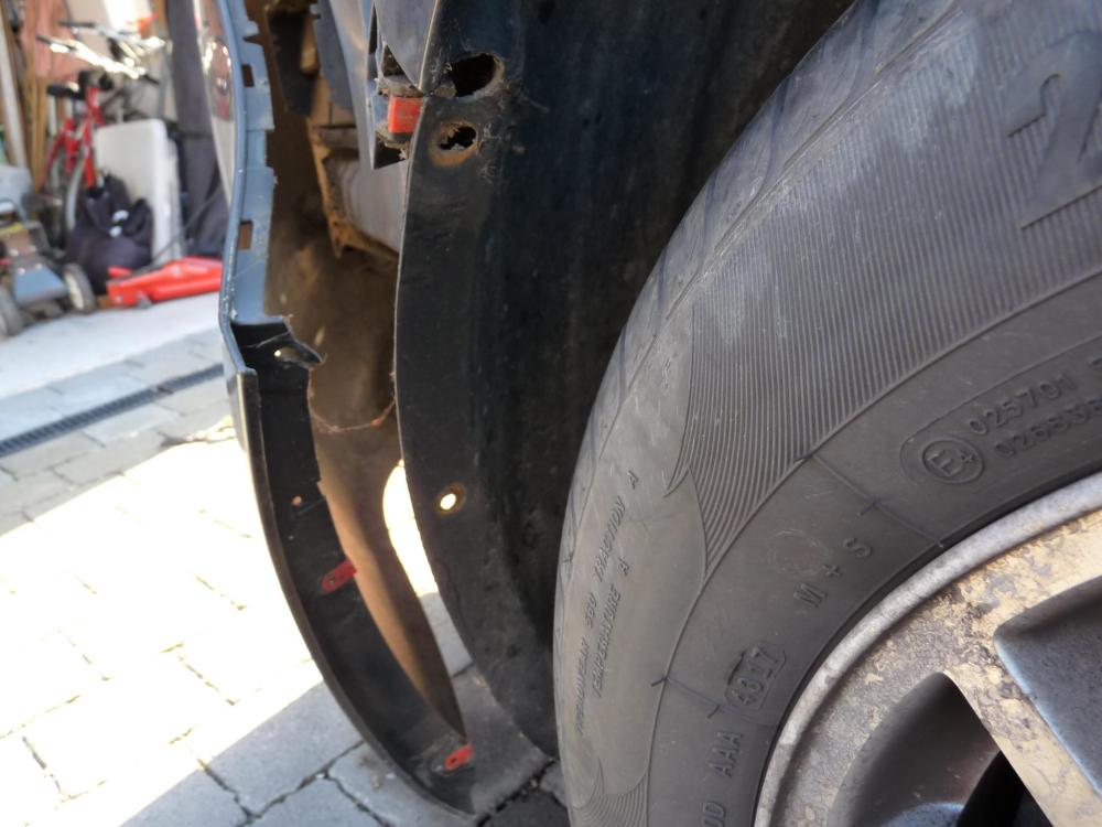

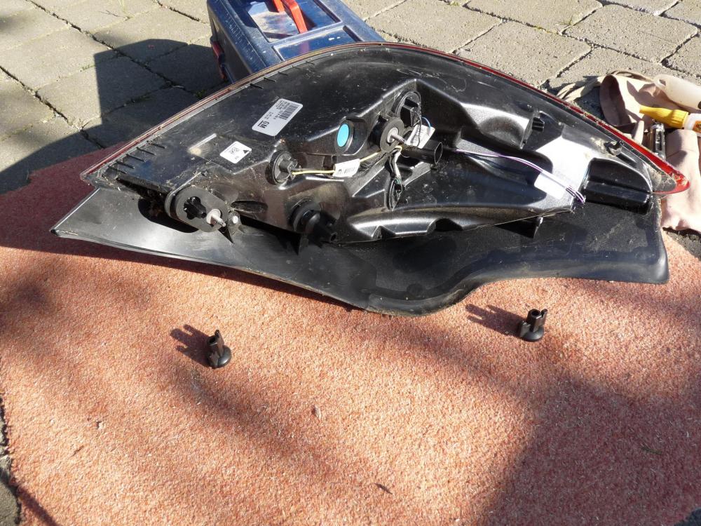

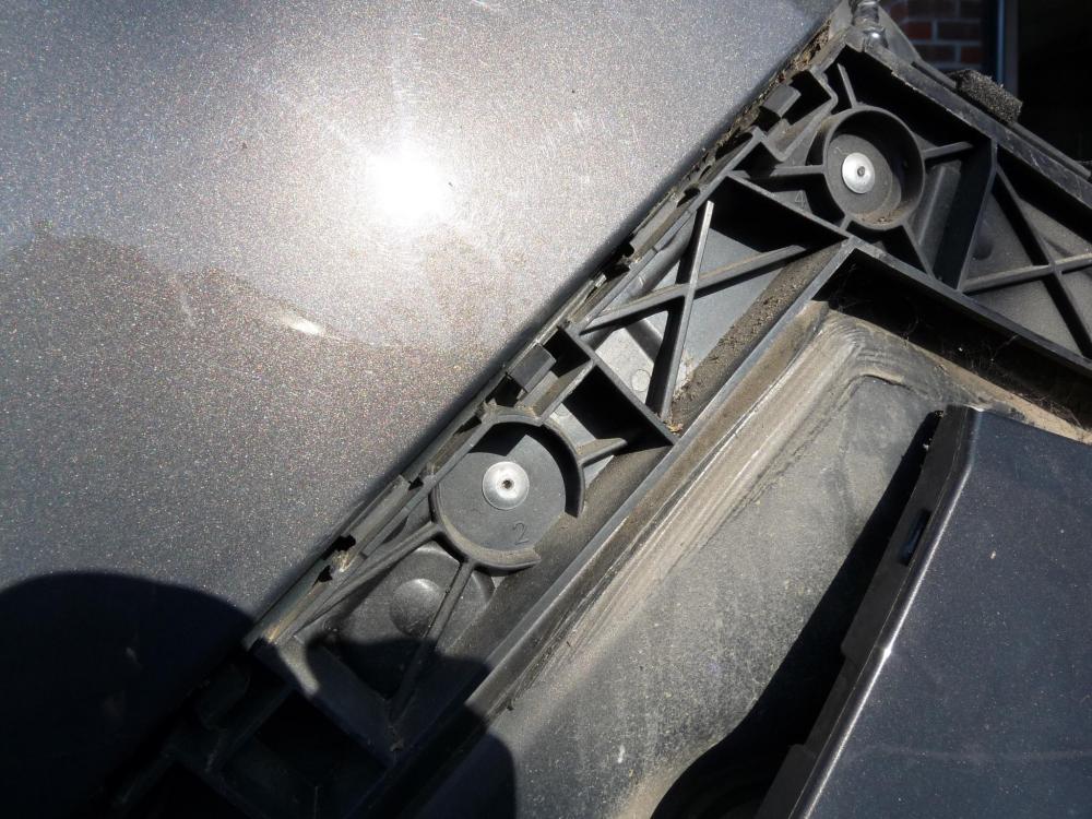

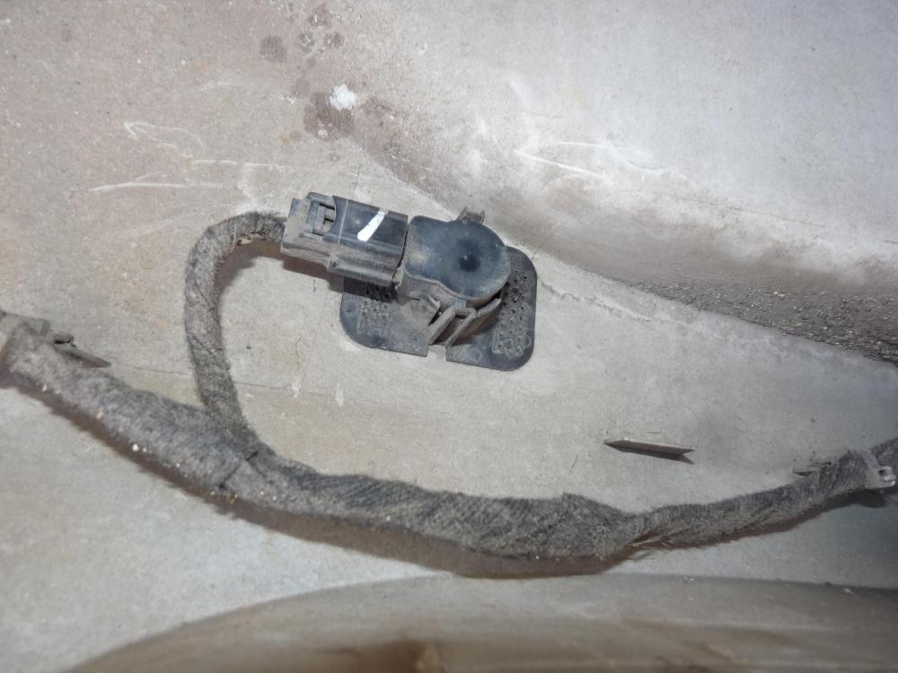

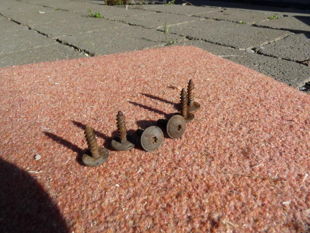

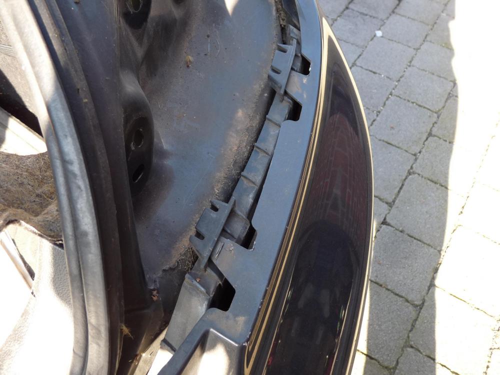

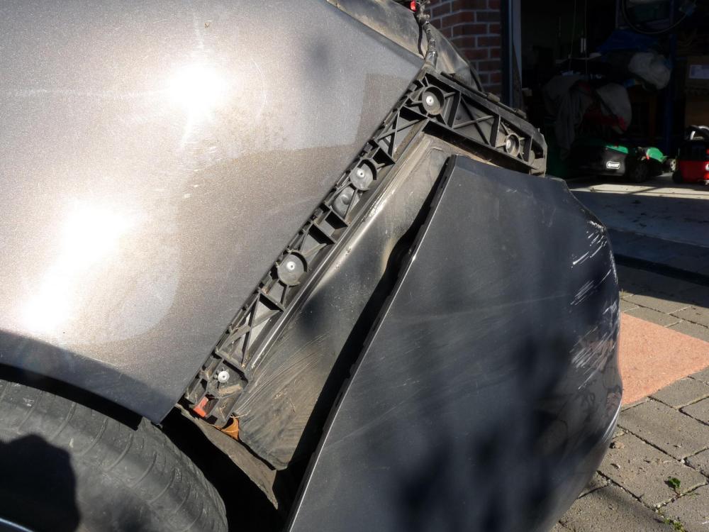

  4. My parking sensors stopped working, front and back, apart from a occasional useless bleep. I noticed that one of the rear sensors was just a tiny bit misaligned, only a milimeter I guess. So I removed the bumper. The sensors are cylindrical and slip into a holder glued or plastic-welded to the inside of the bumper. I noticed that one side of the rectangular plate of the holder of the misalligned one, had slightly lifted away. When I pulled slightly the whole holder came away. I cleaned the surfaces, applied superglue and replaced the holder on the bumper, using the sensor to align itself in the hole. I tested it before replacing the bumper properly and was gratified to find it working, and at the front too. A Youtube video of a bumper removal for a same-year Insignia was useless, being totally different from mine. To remove the bumper, the rear lights must be removed, in order to be able to release the hidden clips. There are 3 plastic wing nuts holding the lights and it is necessary to be a bit brutal with the upholstery to get at them. It may not be necessary to disconnect the lamps if they are carefully hung into the boot - not really recommended - but the connectors are difficult to part. There are 3 torx screws under each wheel arch, and 3 more under the rear of the bumper. Then the bumper must be pulled out sideways on both sides to unclip the sides and the clips which were hidden by the rear lights need to be depressed to release them. Then pull the bumper backwards. The connector for the sensors and plate lights must be parted. It slides onto a clip to stop it flailing around. The pictures show the various clips, the sensor with its rectangular glued plate, the torx screws and their position under the wing, and the rear light with its wing nuts.

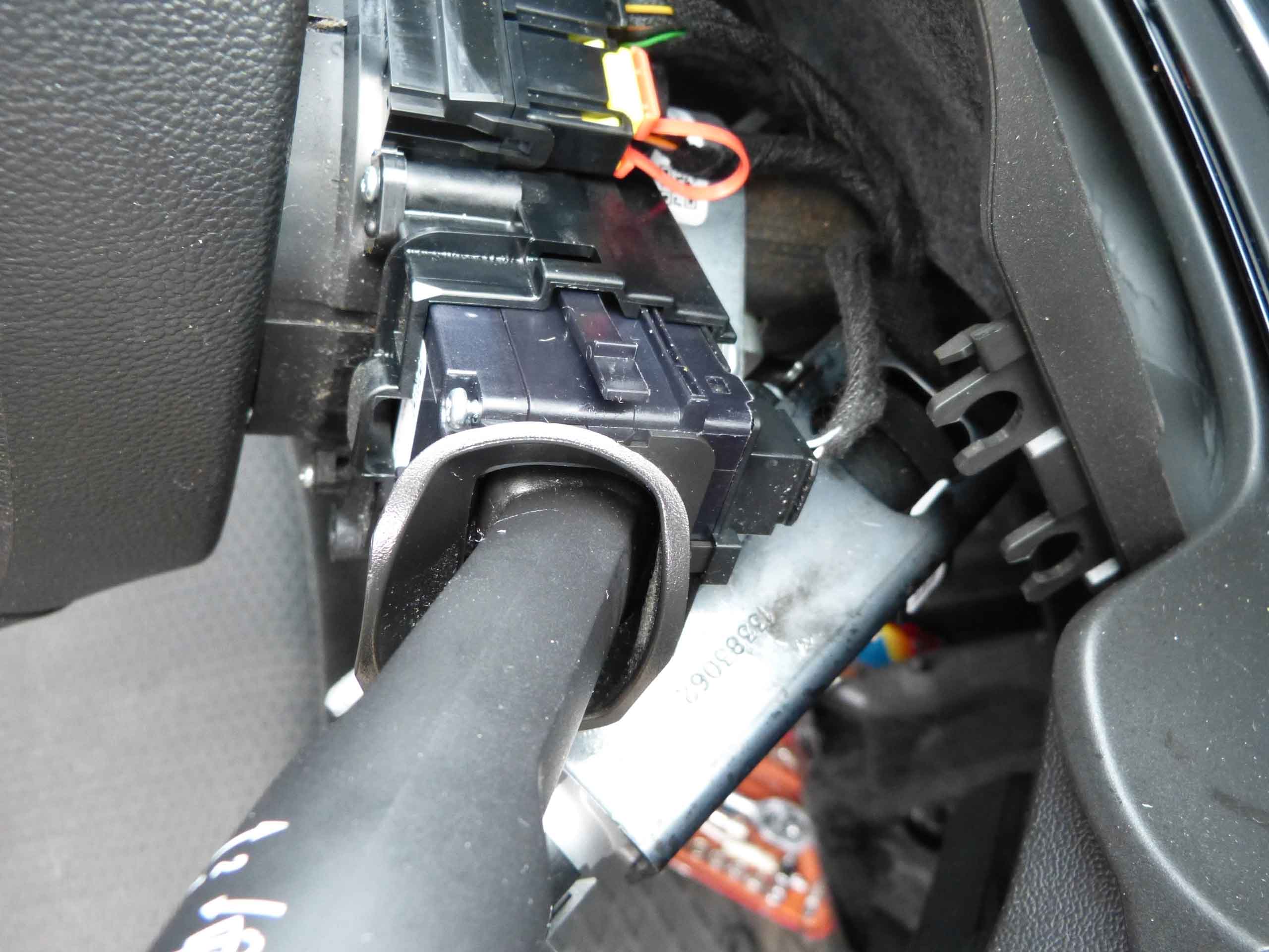

  8. I had difficulty finding out how to access the stalk switches. First release the steering wheel, lower it and pull it out telescopically. The wheel needs to be turned 90° left and right to get access to two screws. The top plastic cover can be prised off, starting by lifting the tabs covering the screws and levering upwards - see photo. (The top cover clips onto the bottom cover.) There is a third screw centrally underneath the lower cover. (6mm socket needed for all 3.) The separate cover over the ignition switch needs to be prised off and manoeuvred out. The stalk picture shows it half out with one locking-clip seen on top. The white connector on the PEC attaches the cable going up the stalk for the rear wiper control; remove it before unscrewing the PEC. The stalk switches connect to the Body Control Module located behind the glove box; I was relieved to find that it was not the problem! The 3 positions of the wiper switch, Intermittent, normal & fast are encoded with resistors on the PEC, they are decoded by the BCM which commands the wiper relays. Sadly I had already ordered a replacement stalk from Ebay before finding the corrosion. It may yet come in handy!

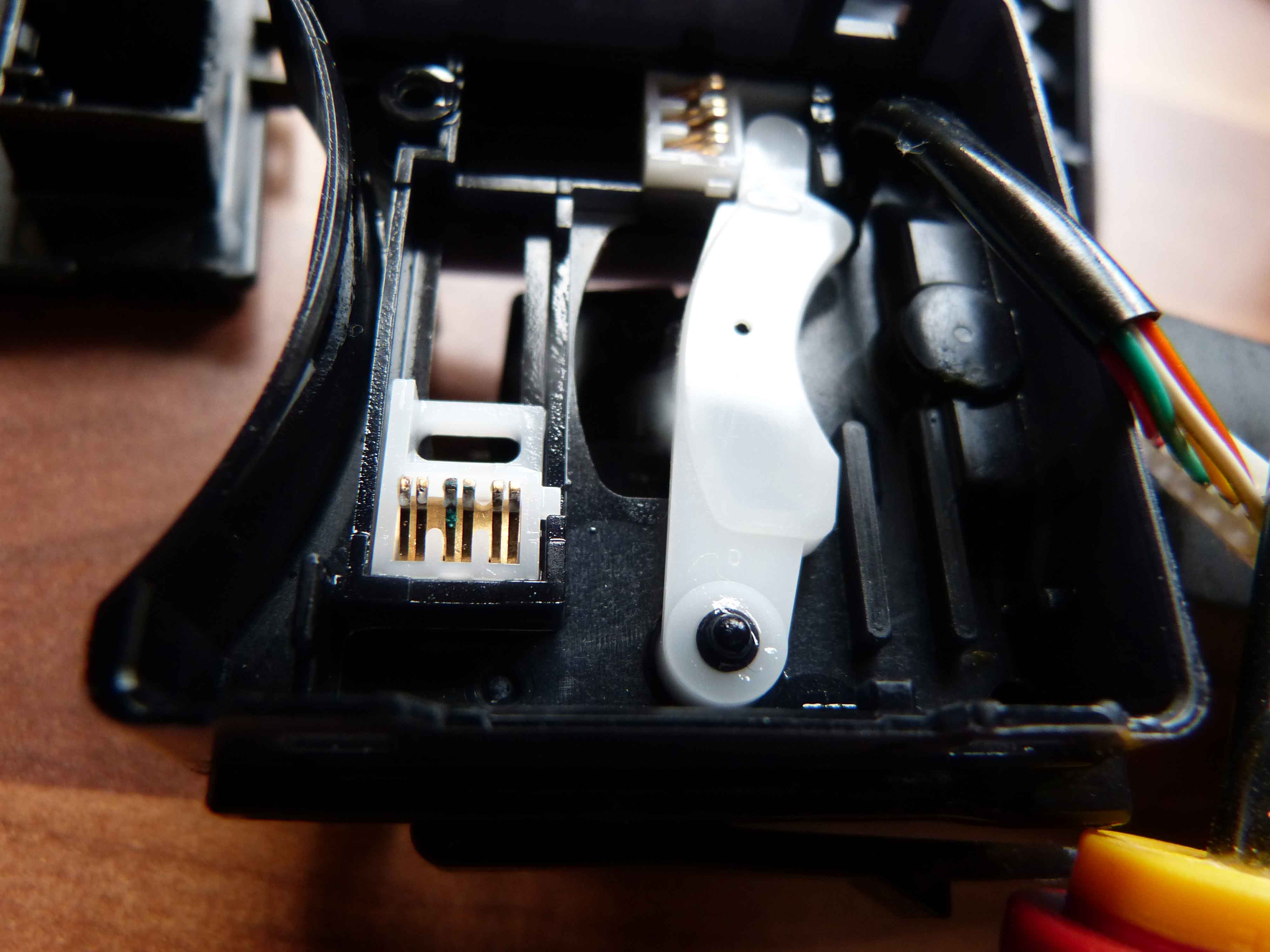

  9. Insignia 2014 diesel eco. The wipers often will not start, except by demanding wash, when they always work. After driving for a while the wipers start working, either using the intermittent selection or either of normal or fast settings, but changing a setting can cause the wipers to stop again and they may then start again after a while. The problem exists on all 3 setting positions, except for the wash-pull. Evidently power does arrive at the stalk switch. Rear wiper works OK. It is puzzling how a bad connection could cause this. I have been testing them while stopped - engine off. Is it necessary to be moving? Is the Computer involved with wiper control? When they work, the speeds are as expected, so the motor seems OK I succeeded in fixing the problem. The wiper stalk switch is removed by squeezing the plastic strips top and bottom and pulling it out of the housing. Unfortunately the release for the connector is out of sight underneath the switch so a bit difficult. The release for this connector is on the inner side facing the control column. There are two screws holding one side of the switch together, but this gives access only to the sprung plunger that holds the switch in the three positions. Taking it apart is unnecessary unless re-greasing is wanted. The other side of the switch can be removed by releasing the plastic lugs. This then allows the disconnection of a small connector and removal of the PEC after removing the screw. The main contact slider can then be removed, noting its orientation. In my case 2 of the contact prongs were corroded. The copper strips had pairs of marks where the slider stopped, which was worrying as it looked as though there might be holes. After cleaning and re-assembly the switch works properly. There is another contact slider, presumably for the rear wiper. I have more pictures of the repair, but they exceed the allowance.
