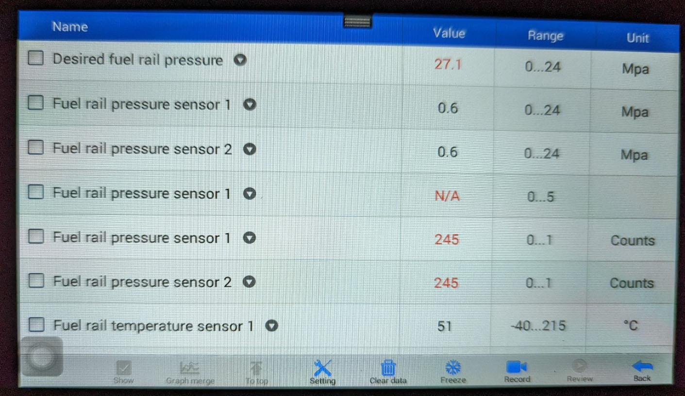

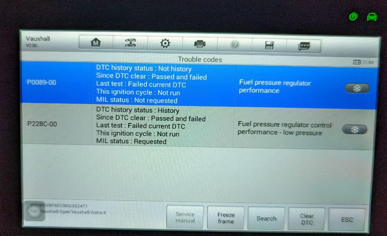

Jabander Posted January 4, 2022 Share Posted January 4, 2022 Hi Guys, I have an ASTRA K 2019 with just 14k miles and just got the following issue.also, I am new to the forum so apologies if this is not the correct place top post my help on. I have a 19 plate Astra k with 14k Miles.Yesterday morning i was driving and Engine power reduced light came on along with ENGINE LIGHT. Plugged my OBD AUtel into it and the following codes came up. 90089-00 Fuel pressure regulator performance and P228C-00 fule pressure regulator performance - Low pressure. I think the first maybe due to the last one. The car took a few seconds longer to start this morning than usual. Please see pics of Live data and codes attached. Any advice and or suggestions on what to test/diagnose andhopefully repair without going to the stealers would be much appreciated. Happy new year to everyone. Quote Link to comment Share on other sites More sharing options...
Vauxhall Owners Club Posted January 6, 2022 Share Posted January 6, 2022 Hi.....welcome to the Club I would firstly replace the fuel filter and ensure that the housing is also in good order (no leaks and seals good) 1 Quote Link to comment Share on other sites More sharing options...
Jabander Posted January 11, 2022 Author Share Posted January 11, 2022 where is the fuel filter located on these? Quote Link to comment Share on other sites More sharing options...
